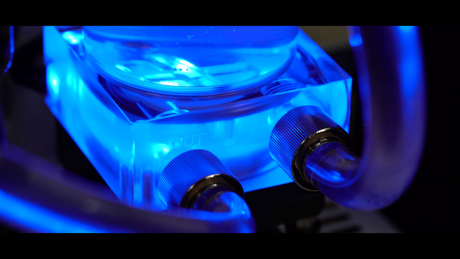

The main troubles relate to the pump/res mounting and fittings. While the 120mm bracket for the pump is great, not having a tube clamp significantly reduces its practicality. You can only mount to the bottom of the pump, which means the bracket has to be placed horizontally on the floor of the case or on the PSU shroud. We were a bit lucky in that our case has a bunch of slots that can be used for this purpose, but some cases won't have these on their shrouds. Normally, that would mean you could attach the bracket on the radiator up front or simply a front fan mount, but because there's no tube clip, you would have to place the reservoir sideways so that it lies horizontal. This definitely can be done, but it's impractical in many scenarios.
The other issue is the lack of angled adaptors. Generally, soft tubing won't really need many of these, as the tube can do almost all the work. However, soft tube does kink when bent too tightly, which can be easily avoided with angled adaptors in many tight spots. For our test system, the main issue was with the connections to and from the pump top. The EK-Uni bracket essentially meant the reservoir could only be pushed back so far inside the case, and the only orientation we could realistically use was having the inlet/outlet facing the window, as one side was next to the radiator and the other below the GPU. The thing is, the tubes only just fit in that orientation without kinking; they're resting against the window in the setup. Two 90-degree adaptors would have solved this so easily and would give the system a great look too. Again, this isn't some deal breaker, but it's a little annoying and could potentially make things tricky in a less forgiving chassis.

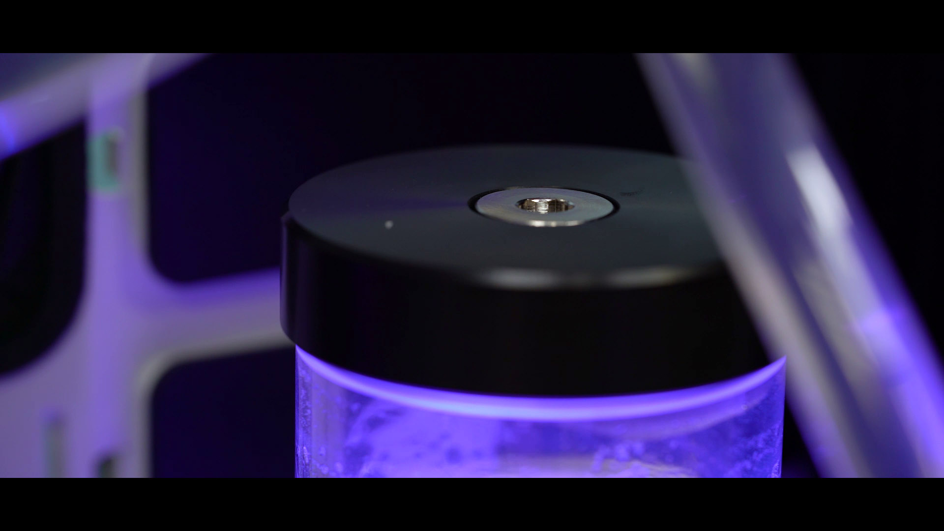

The issues stem from how you're actually expected to put the coolant into the loop. The top of the reservoir has a port which you can use to fill the system, but it has a recessed stop plug in it. EK's done this for years now; the plugs are recessed for aesthetic purposes, but that does mean you need a tool to undo them. For some reason, our kit didn't have the correct size Allen key for this, so we were looking around for something to undo this top with. It's fine if you do have an Allen key set somewhere, but the 6mm size (we think that's the right one) is a bit uncommon. The instructions actually don't bother with this and instead just say to take the top off and pour the coolant inside. This presents its own issues, though, as unscrewing the top can lead to accidentally unscrewing the bottom! Fortunately, we noticed that we'd unwittingly loosened the base of the reservoir from the pump top before filling; it wouldn't be so good if it loosened during the fill process, that much is sure.
We also encountered a minor snafu in trying to use the reservoir filter that's included. We attempted to use it, figuring it would help the system bleed air faster by disrupting the flow. Unfortunately, what actually happened was that it destroyed the flow entirely and prevented the system from ever filling, so we fished it back out and threw it to the side. We've always left them out before, and it looks like we'll continue to do that. It's not even listed in the instructions as a step, so it seems even EK doesn't think they're that important either - perhaps it's just a legacy inclusion?
